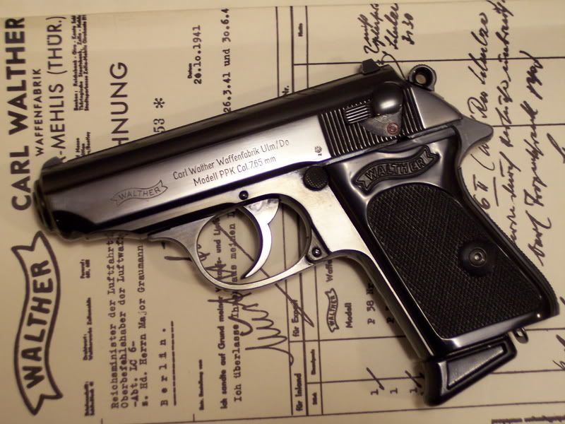

Just acquired my first Walther, a 1942 PPK. I bought it from banddr2 (if any of you ever have the chance to do business with him, by all means do) and couldn't be happier. I'll try to get some pictures up soon, but I've put a postwar slide on it, so it looks much as it did when its previous owner did the same (see link).
Here's my question: note how the grips (not original, of course) fall several millimeters short of the slide, revealing the action underneath (also visible on the other side, same as on some pistols I've seen for sale on GA). What is the cause for this? Is it that the frame is war-time produced and the grips are postwar? Are these American-made grips? Earl tells me every PPK appears the same way, but that's obviously not the case. I doubt it could compromise performance, but for aesthetic reasons, and in case the exposed action dirties the internals faster, I'd be eager to find grips that ride closer to the slide. Since Earl can't help, anyone have any insights/recommendations?

Pre War and post war Walther PPK grips do not have that large gap you mention between the slide and top of the grips.
Interarms (USA Made) grips have generous tolerances as do alot of the aftermarket styles. If you can find a pair of brown plastic Walther PPK grips from the 1960's that should solve the problem on your pre-war pistol.

153- Thanks for the advice. I thought they might be American, more likely Interarms than Smith, but Earl told me yesterday (and who was I to question Earl) that American-made grips wouldn't even fit on the frame. I actually live about an hour from his shop, so maybe the thing to do is bring the pistol in and let him see what I mean. If German-made grips are the answer, I also don't mind his price of $45 for a black pair.

About a year ago, I bought a 1966 PPK .32 cal. "shooter". The grips and magazines were near mint so I wanted to replace them and stash the originals. I bought black 2 piece grips from a seller at GunBriker, advertised to fit "any wartime or post war PPK" for $40 (+ S&H). At about the same time, and for an unrelated reason, I needed to replace the grips on a currnet manufacture S&W PPK. I called and ordered grips from S&W for under $12 (+ S&H). After everything arrived, I compared the two, and they were exactly [exactly] (exactly) the same. So I paid $40 for $12 grips. Lesson learned. Not to take anything away from Earl or anyone else, but I now have the S&W grips on my 1966 .32 cal PPK and they fit perfectly. You can draw your own conclusions as far as a 1942 wartime pistol, but the $12 S&W grips may your most inexpensive option (if you don't mind black).

I've found the same thing with the PP frame. The stock plastic grips from my S&W PPK/S-1, a spare pair of "West Germany" marked Walther grips from Sportsman's Guide, my new "Interarms" packaged olive wood grips from CDNN, and the pressed wood grips from my late war PP are fully interchangable... :)

Thanks for the kind words. The grips on your ppk I am sure are american, Gadsden, grips. If you look at the under side of the right panel, I believe, you will see where they were altered with a dremel to enable them to fit. That is how I bought it. Here is a pic of a 68 german ppk:
Someone correctly mentioned above that the American grips are shorter and have a more generous gap. Earls has german black grips that can be altered to fit that would look nice and should fix the aesthetic appearance.

After reviewing your pictures, and digging out my '66 PPK, I think the "gap" between the slide and the top of the grips is similar. I just maybe hadn't noticed before? If you'd like a pic, please send me a PM with your e-mail address and I'd be happy to send you one!
