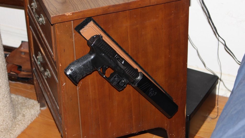

In fact my QFE is my nightstand HD weapon with the Osprey and Viridian C5L mounted.
In fact I cobbled together a mount on the side of my night table with magnets that holds my weapon....
