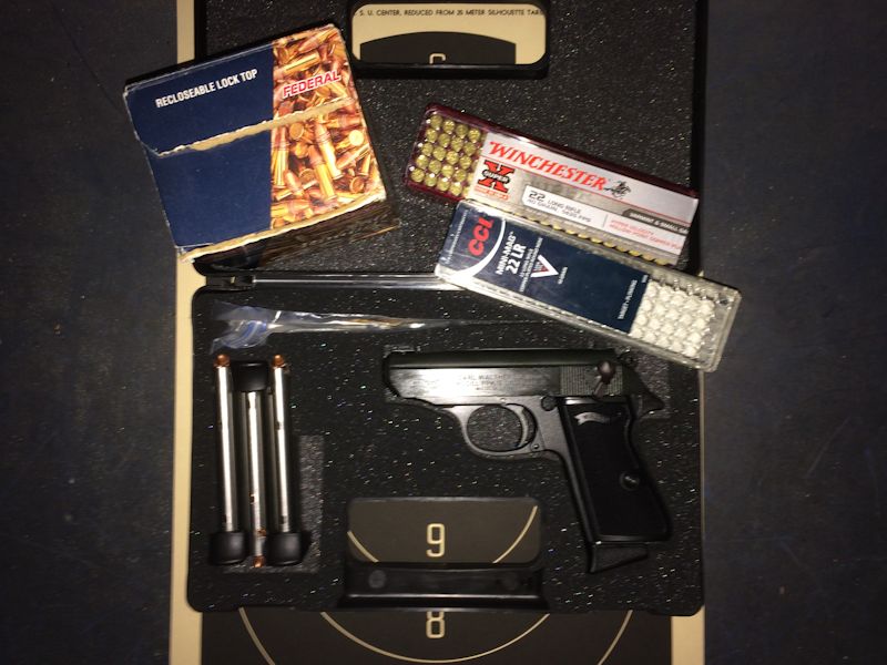

I took my new PPK/S 22LR to the range today along with some CCI Mini-Mags, Winchester Super X and Federal Bulk.
I fired 30rds of the CCI, 30rds of the Winchester and 60rds of the Federal. Accuracy was decent, the sights were small, recoil was basically nil, the SA trigger pull was good and the DA trigger pull was waaaaaay heavy. I had one problem as far as reliability goes. I shot a total of 12 10rd mags through the pistol. Four of the times, the second cartridge from the magazines failed to feed. This was the first cartridge that should have fed automatically. It happened with all three types of ammo and with various magazines, so I'm confident that it's not the ammo or magazines. Has anyone else experienced this? I can't really figure out why the second cartridge from the magazine would fail to feed sometimes. Other than that, I'm very pleased and am looking forward to getting a suppressor for it. I'll take suppressor suggestions too if anyone has used one on this pistol.

Are you sure that this occurred with all 3 brands of ammo? I ask because while the PPK/S .22 loves CCI Mini Mag and other such premium high velocity ammo, Federal bulk ammo and Winchester ammo such as those in your pic typically FTF/FTE.

Yes, I'm 100% sure that it happened with each type of ammo. I even tapped the magazines to seat the cartridges to the rear after the first couple of failures to feed, but it happened again a couple of times after that.
While the pistol generally didn't eject the Federal spent cases with the same velocity as the CCI and Winchester, they all ejected fine. I'm very pleased about that because I expected the weaker ammo to cause trouble. FYI, that particular Winchester ammo has about a 200ft/sec higher velocity listed on the plastic box than the CCI does.
