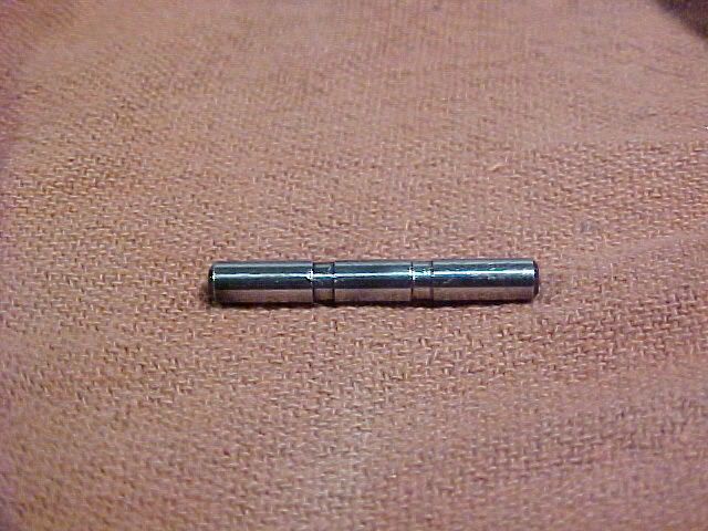

Next, take the punch and small hammer and drive the main trigger pin out. You will need to use the small piece of wood to prop the frame up so that you can drive the pin completely out.
4
This pin will have two grooves in it.
****This is the first step in making the P99-QA trigger action unsuck. Polish this shaft with the jewelers wheel until the shaft shines. Do not polish the ends of the pin, as you will want to keep the black oxide on them.

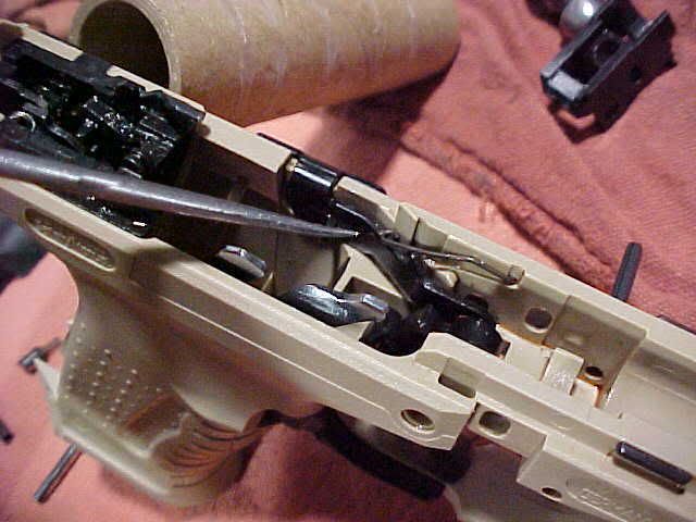

Next, remove the slide stop and its spring (spring noted by pointer).
Next, remove the trigger cam.
You will need force the transfer arm to the side to remove the plastic trigger cam.

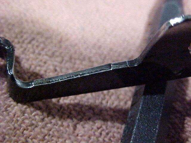

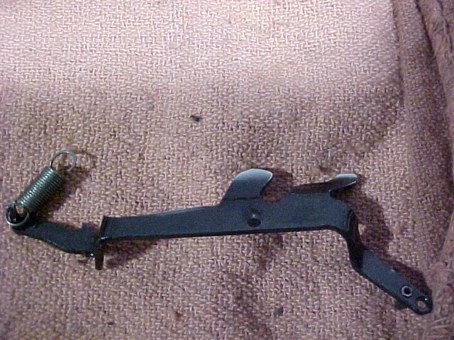

****This is the next step in making the P99-QA trigger unsuck. Take a look at the stock transfer arm casting.
Notice how rough the stamping process left the steel. Now take a look at the transfer arm after a little sandpaper, jewelers wheel buffing, and then cleaning an oiling. (The second picture shows the area to polish)

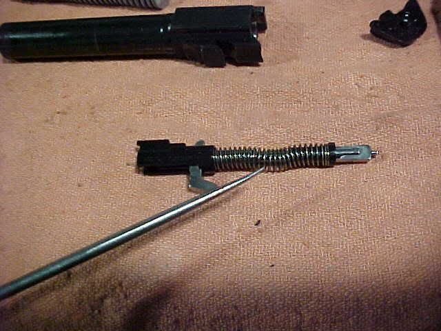

Take the slide, and remove the rear striker assembly retaining plate. This information can be found in your Walther Manual.
4
Take out the striker assembly.
****CAUTION. YOU WILL WANT TO WEAR SAFETY GLASSES FOR THE NEXT STEP. YOUR FINGERS WILL GET PINCHED. THERE IS NO WAY AROUND IT.
Walther warns us not to take the striker assembly apart. This is due to the fact they do not want you to ruin the firing pin nose or shoot your eye out with the main striker spring.
****Take note here of the P99 VS the P99-QA striker spring pictured above. The P99 uses a straight spring, while the QA has a bent spring. I believe this is what causes some of the ?gritty? feeling you feel in the trigger due to the spring rubbing the firing pin. More on this later?.
To save the firing pin nose, use a paint can plastic cap shown here with a hole in it using the small punch.
Take the striker assembly and put the nose of the firing pin into the hole in the cap.
Push the spring down. Your fingers will get pinched. It hurts. Deal with it.

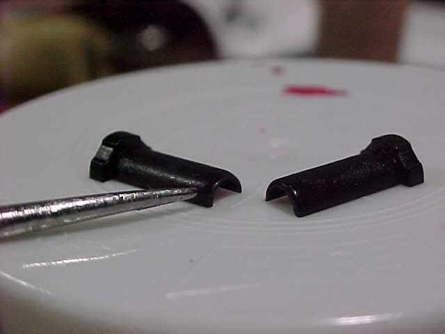

Remove the two plastic retaining lugs. The assembly should appear as such.
4
****This is the next step in making the P99-QA trigger unsuck. Take the edge off of each plastic retaining lug using your jewelers wheel. Do not use polishing compound. Do not use heavy force. You can see the rounded VS rough plastic lug. Rounding these edges makes the QA striker spring glide smoothly over them?.

This is the stock transfer arm finish compaired to the sanded and polished transfer arm.
