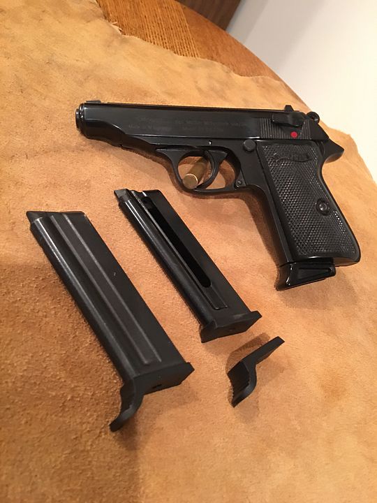

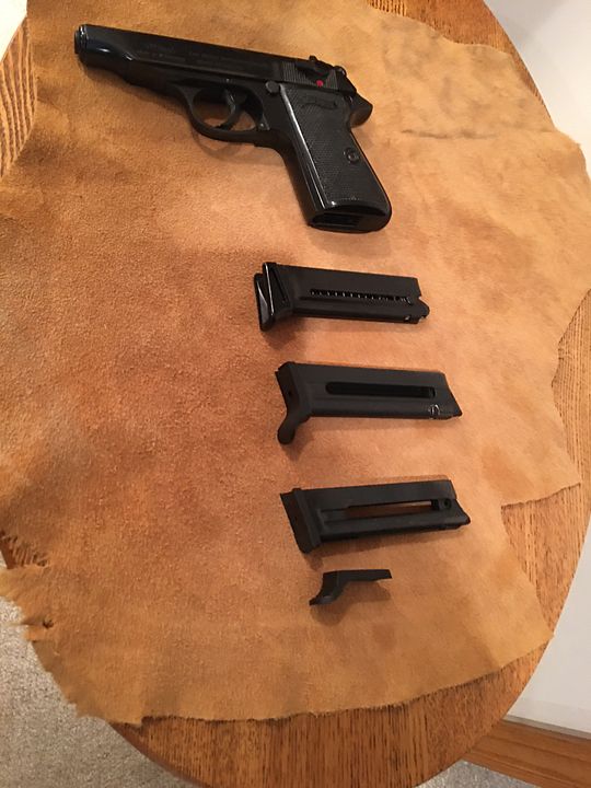

Update on my 1971 Walther PP22 and Triple K mags.
Got home and picked up my gun from my dealer. It is even better than what I remembered when I bought it. These photos don鈥檛 do it justice.
It could have been refinished at one time but if so, it was a very good job (again these photos don鈥檛 support that).
I received a magazine from TipleK and it works perfectly. Loading 8 rounds into both the OEM mag and the Triple K sample seems to work the best. After making sure the Triple K mag works at the range (it did), I filed down the base pad to make it flat. It looks and feels great this way.
In addition, I had in my stash, another Triple K magazine I had purchased for an FEG AP22 some time ago. It also works great with 8 rounds. It sticks out from the base a little but it makes a good spare.
I called and talked to the Triple K staff today and thanked them for a great product. Again, they are many times the only show in town. At times I enhance the performance by tweaking them {very little) and they are good to go.
These things are functioning very well in my Walther TPH, Beretta 70 .32acp, Beretta 71 22 LR, and others.
