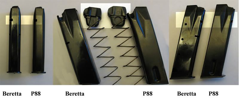

I do not remember where, but I read somewhere that the P88 mags and the beretta 92F mags use the same mag body and follower the only difference being the location of the cut for the magazine catch. It is true I tried it and it works great.
Hey so if you take beretta 92f mags and cut a small notch for the magazine catch they work perfectly in your p88.
I would trust my life to it.
You can buy 92F mags for about between 10 and 20 bucks.
It sure the hell beats spending 100 dollars on 1 mag.

Years ago, I just set up a mill to cut the notches and had a bag full of magazines in 20 minutes:) . It takes a bit longer to do with a Dremel and very ling with a hand ile.
Way back then all we had were 15 round Beretta magazines, 18 round Ram-Line magaines and I even did a couple of 30 round extended mags.
