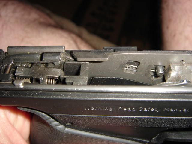

Thumbs up PPS Slide Stop: Date Coded: BB
Posting an image of my slide stop. No issues thus far. PPS date coded: BB

alfanator Unproven
Just ordered it from S&W, which assured me that it is the updated version. Will update when i get the part.
Part number is 2686074 for $10.95.
